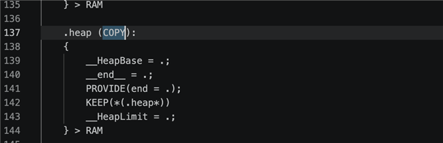

I changed stack and heap sizes via __HEAP_SIZE and __STACK_SIZE defines. Change is confirmed by .map file, but RAM usage(reported by linker flag --print-memory-usage) is not affected.
No matter what size I set to defines, RAM usage reported by linker stays the same.
How to fix this?
  • I think by default head and stack are defined as COPY sections and not the NOLOAD (modules/nrfx/mdk/nrf_common.ld: line 137) , COPY sections are not included in the print mem usage option.
    if you want --print-memory-usage to include heap and stack aswell then you need to change the linker script to NOLOAD , prestine build and check if that works.
  • Does not help. Even if I remove (NOLOAD) / (COPY), RAM usage does not change.
  • If you have changed from COPY->NOLOAD, that should have worked.
    can you show me your arm-none-eabi-ld --version?
    Are you using bfd or gold version of the linker. if you were using bfd, then my suggestion should have helped.

    I'm using gold. Tried with BFD, same result.
    Linker command is
    $(DIR_BUILD)/$(BUILD_NAME).elf: $(OBJECTS) $(MAKEFILE)
        $(TC_CC) $(OBJECTS) $(LINKER_FLAGS) -o $@
    Linked with gcc, not ld.
  • hmm, then nrf_common.ld does not seem to be built to count the heap and stack usage using --print-memory-usage.
    Else change     .heap (COPY) : -> .heap (NOLOAD) :
    and add       . = MAX(., __HeapBase + __HEAP_SIZE); in the heap definition for heap to actually take space somethign like below
    .heap (NOLOAD):
        __HeapBase = .;
        __end__ = .;
        PROVIDE(end = .);
        KEEP(*(.heap*))
        . = MAX(., __HeapBase + __HEAP_SIZE);  ///// add this
        __HeapLimit = .;
    } > RAM
