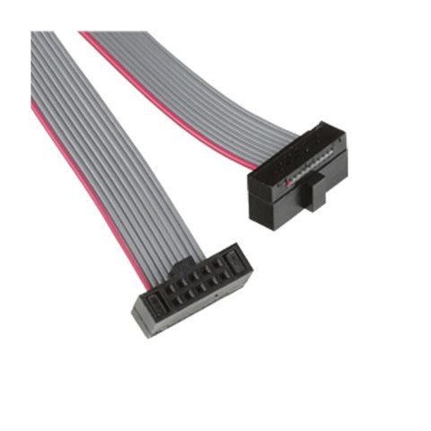

In the link below is the P19 debug out connector. Pin numbers 1 and 2 start from which direction?
https://docs.nordicsemi.com/bundle/ug_nrf54l15_dk/page/UG/nRF54L15_DK/program_debug/debug_out_ext_board.html
