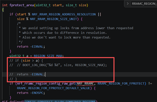

Nrf desktop hid mcuboot development
I want to expand the flash allocated to mcuboot on the NRF desktop, but it failed to start after compilation

I couldn't start after enlarging the mcuboot partition to 64kb, and at the same time, I opened the mcuboot log

The mcuboot log output is as follows
00> [00:13:16.873,432] <dbg> mcuboot: main: Starting Direct-XIP bootloader 00> [00:13:16.873,609] <dbg> mcuboot: boot_get_slot_usage: Primary slot: version=3.1.1+0 00> [00:13:16.873,794] <dbg> mcuboot: boot_get_slot_usage: Secondary slot: version=3.1.1+0 00> [00:13:16.873,983] <dbg> mcuboot: boot_version_cmp: boot_version_cmp: ver1 3.1.1.0 vs ver2 3.1.1.0 00> [00:13:16.874,192] <dbg> mcuboot: boot_validate_slot: boot_validate_slot: slot 0, expected_swap_type 0 00> [00:13:16.874,374] <dbg> mcuboot: bootutil_img_validate: bootutil_img_validate: flash area 0x7ce4 00> [00:13:16.874,550] <dbg> mcuboot: bootutil_tlv_iter_begin: bootutil_tlv_iter_begin: type 37, prot == 0 00> [00:13:16.874,744] <dbg> mcuboot: bootutil_tlv_iter_next: bootutil_tlv_iter_next: searching for 37 (65535 is any) starting at 348760 ending at 348969 00> [00:13:16.874,995] <dbg> mcuboot: bootutil_tlv_iter_next: bootutil_tlv_iter_next: TLV 16624 found at 348832 (size 1) 00> [00:13:16.875,205] <dbg
Could you please help me take a look at this issue? It has been bothering me for a long time
