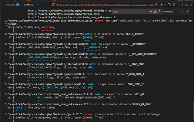

    Thank you for your response.
    We tried building the I2S sample by referring to the nrf54lm20dk_nrf54lm20_common.dtsi as suggested and created an overlay accordingly. However, we are encountering a build error during compilation.
    Error observed:
    We have attached a screenshot of the complete build error for your reference. Could you please help us understand how to resolve this issue or if any specific configuration changes are required for nRF54LM20B?
    If any additional details (overlay file, prj.conf, logs, etc.) are needed, please let me know — I will share them.

  • Hi Subhiksha,
    Could you try to share the error again? I don't see anything in the box under "Error observed:"
    Ususally, Insert->Code works for sharing code and logs.
    Note that a carbon copy of the .dtsi from the test samples is not sufficient for the i2s_codec sample. The sample tries to fetch the i2s_codec_tx alias, which is defined in the overlay files for the supported boards for the sample. Did you define this in your .overlay for the nRF54LM20B?

  • Hi Maria,
    Actually, i'm not able to share complete logs as you mentioned. Please refer the image attached in this for "error observed".
    Did you define this in your .overlay for the nRF54LM20B?  - Sorry i didn't get this what do you mean it? can you please come again?
  • Hi Subhiksha,
    I meant to ask if you have included something like this in your .overlay:

  • Hi Maria,
    May I know which sample application you have taken and built it?
    Here I'm attaching the overlay file which i have been using.

  • Hi Subhiksha,
    I used zephyr/samples/drivers/i2s/i2s_codec. I can see now that you wrote audio_codec, which I assume is the zephyr/samples/drivers/audio/codec sample. My apologies for the confusion.
    I am not able to reproduce the errors you showed in your screenshot with the audio/codec sample. Are you building another sample here? Or are you building your own application?
    Also, I note that your build target is the nrf54lm20dk/nrf54lm20/cpuapp/ns. Make sure that you have an .overlay for the build target you are using.

  • Hello Maria,
    Thank you for your clarification.
    We have tried building both samples:
    • zephyr/samples/drivers/i2s/i2s_codec
    • zephyr/samples/drivers/audio/codec
    However, in both cases, we are still encountering build errors similar to the one shared earlier.
    Additionally, we noticed that there is no default board-specific overlay file available for nrf54lm20dk/nrf54lm20/cpuapp/ns in these samples. So we created a custom overlay by referring to the nrf54lm20dk_nrf54lm20_common.dtsi file, but the issue persists.
