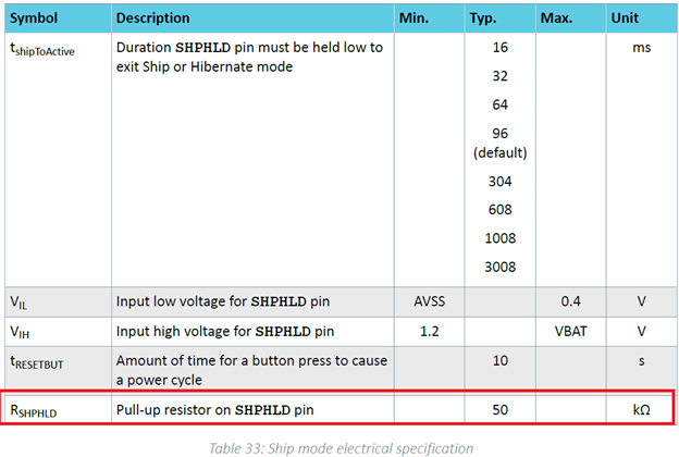

Customer using nPM1300 would like to know what are the minimum and maximum values of Rshphld? These values are not in the datasheet.

Hi, Nic.
Sorry for the delayed response.
The tolerance of the 50k resistor is ±20%.
