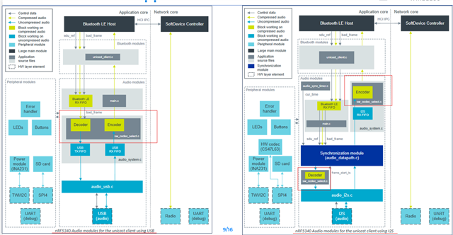

  • Thank you for your reply.
    However, there is one point that I do not fully understand, and I would like to ask a follow-up question.
    1. Should we understand that there are currently no plans to officially support bidirectional stereo streaming with a USB audio source on the nRF5340 platform?
    2. You explained that in the case of bidirectional stereo streaming, the CPU load exceeds 90% due to both encoding and decoding processes. You also mentioned that this limitation is related to the performance capabilities of the nRF5340 SoC (presumably the application processor).
    However, it seems that the CPU load caused by encoding and decoding should apply to both USB audio sources and I2S audio sources, as illustrated in the figure below. If that is the case, does it mean that bidirectional stereo streaming over I2S would also be unstable due to the same CPU limitations?
    As mentioned earlier, the official documentation states that I2S supports bidirectional communication.
    Could you please clarify why bidirectional communication is considered reliable when using I2S, while it is considered limited or unstable when using a USB audio source?
    Is the difference caused by additional CPU overhead introduced by the USB audio stack, buffering, or sample rate conversion? If so, could you provide more details on where the extra processing load comes from and how significant it is compared to the I2S case?
    Thank you for your support.
    It is supported by HW, given needed optimization in SW, but not included as a configuration in the default version of the Audio application. I am unfortunately not able to discuss future plans for what the Audio application includes.
    I2S as source is a bit more flexible due to supporting lower sampling frequencies. Using a sample rate of 24kHz or 16kHz reduces the encoding time and therefore the CPU load as well. In the Audio application, 24kHz is the default sample rate when bidirectional streams are enabled. So this is why bidirectional streams with I2S source is stable.
    I don't have estimated CPU load values for 24kHz and 16kHz at this point.
    You can reduce the sample rate for the USB source mode, but note that this will activate the sample rate converter which needs some processing power. See i.e. the following commit in a forked sdk-nrf repo: https://github.com/rick1082/sdk-nrf/commit/aa5c816f842bed449641a9fbf169b2651378ee36. There, the sample rate for bidirectional stream is reduced to 16kHz, which solved an issue where the CPU load was too high to process streams with higher sample rate in a modified Audio application. Note that the symbol CONFIG_BT_AUDIO_PREF_SAMPLE_RATE_16KHZ is equivalent to CONFIG_BT_AUDIO_PREF_SOURCE_SAMPLE_RATE_16KHZ in nRF Connect SDK v3.x.x.
    Maria
