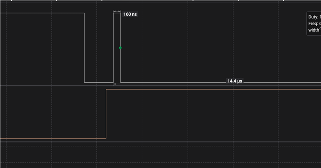

nRF54L15 TWIM hardware does not wait for clock stretching??

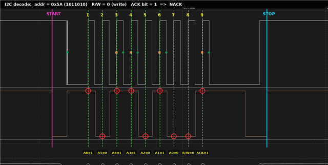

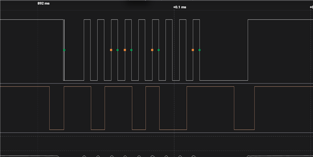

i2c_write_read() returns -5 (EIO) immediately when writing register 0x01 to the sensor. Logic analyzer confirms the sensor clock-stretches SCL for ~14µs+ after receiving the byte while switching internal modes.
Controller -NORA -B206 (nrf54l15)
What works: Pure reads, writing 0x00 to same sensor, all other I2C devices on bus — no issues.
Already tried: CONFIG_I2C_NRFX_TRANSFER_TIMEOUT=5000 — no change. Error fires instantly (hardware event, not software timeout).
