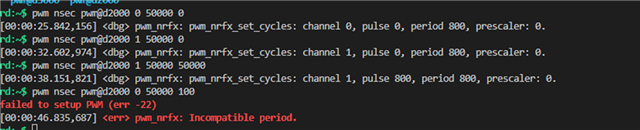

I have removed the custom driver and just enabled PWM shell and I can reproduce the bug typing this commands:

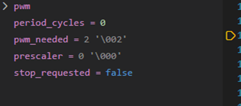

Here the debug watch data of the pwm_nrfx_0_data structure during the test.
Boot:

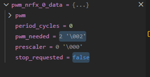

After: pwm nsec pwmd2000 0 50000 0:
(I would aspect the pwriod_cycles t be equal to 800).

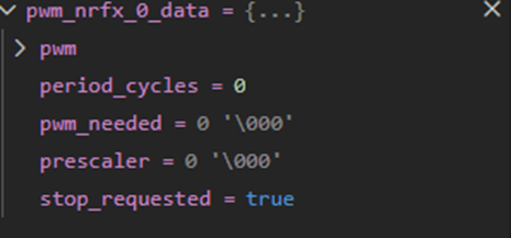

After: pwm nsec pwmd2000 1 50000 0:

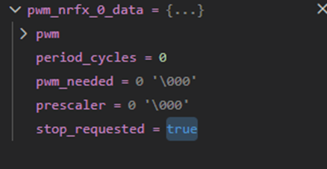

After: pwm nsec pwmd2000 1 50000 50000:

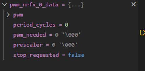

After pwm nsec pwmd2000 1 50000 100:
I hade basically this sequence of commands in my custom driver that is why I have found this issue.
I believe the period_cycles of the driver instance is not properly set when pwm is configured with 100% pulse...
