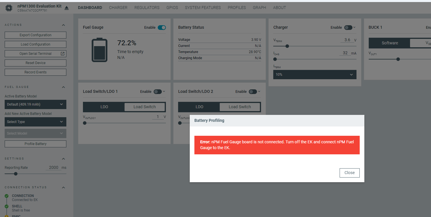

I am facing an issue while configuring battery charging and discharging parameters in nPM PowerUP v2.2.4. The tool currently provides a minimum battery capacity option of 400 mAh, and I am unable to configure or generate settings for a 40 mAh battery.

  3. Whether it is possible to use the fuel gauge functionality without the dedicated nPM Fuel Gauge Board.
    Recommended approach for performing charge/discharge testing and SOC estimation using only:

At the moment, I do not have the nPM Fuel Gauge Board available, so I would also like to understand the limitations and supported workflow without it.

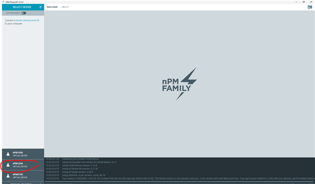

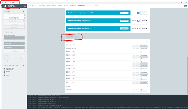

    For the best accuracy it is recommended to profile your own battery with nPM PowerUP and nPM-EK.
    You can also find some generic pre-profiled battery models (for this capacity range) under nPM1304 Virtual Device for early evaluations
    You can save the model as a .inc and use with you application.
    For more info. Using pre-profiled battery models
    Recommended charger configuration settings depends on your battery specifications annd datasheet. Battery model is just for fuel gauging and it does not configure any charger or PMIC parameter. You need to refer the battery datasheet and configure the parameters.
