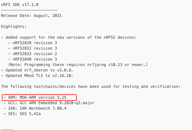

Hello Nordic Team,
I am working on an nRF52833 project using nRF5 SDK 17.1.0 with Secure DFU Bootloader.
Environment:
  • MCU: nRF52833
  • SDK: nRF5 SDK 17.1.0
  • SoftDevice: S140 7.2.0
  • IDE: Keil uVision 5
  • Compiler: ARM Compiler 6.24 (ARMCLANG)
After flashing, OTA DFU is not working and device advertising is also not starting.
I am not getting any logs, so I checked the CPU registers using:
nrfjprog --readregs
Why is this happening? In Segger I am not facing any problem, but in Keil I am getting issues while doing OTA. Please give me the solution.

C:\Users\admin>nrfjprog --memrd 0x10001014 --n 4
0x10001014: FFFFFFFF |....|
I checked on Google and found that UICR writing is not happening, and because of that the SVCI function is crashing. Why does this issue occur, and what is the solution for it?
Please share the .sct (scatter) file for both the application and bootloader.
