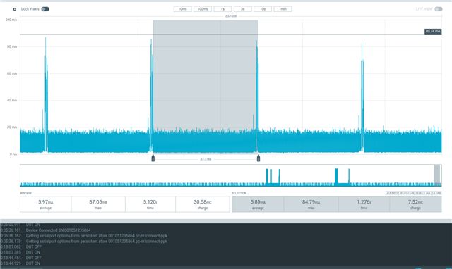

Power profiler observation:
I can see regular current peaks of approximately 80 mA every ~1.27 seconds while the device is in the idle state. I assume these are related to LTE-M paging/DRX activity, but I would like confirmation on how to interpret this. Despite these periodic peaks, downlink MQTT traffic does not always appear to page/wake the device into RRC Connected.

    Quite common DRX paging cycle is indeed 1.28 seconds which matches the peak seen in the PPK2 plot.
    Very strange that MT paging wouldn’t work in normal DRX mode and especially MQTT+TCP based connection. Which carrier is used and is it an MVNO SIM? It’s quite common that with MVNO SIM the IP NAT route is kept open in the cellular IP network from the server towards the device only ~60 seconds at best, i.e. IPv4 based traffic towards the device doens’t have any route to the device anymore after this timeout.
