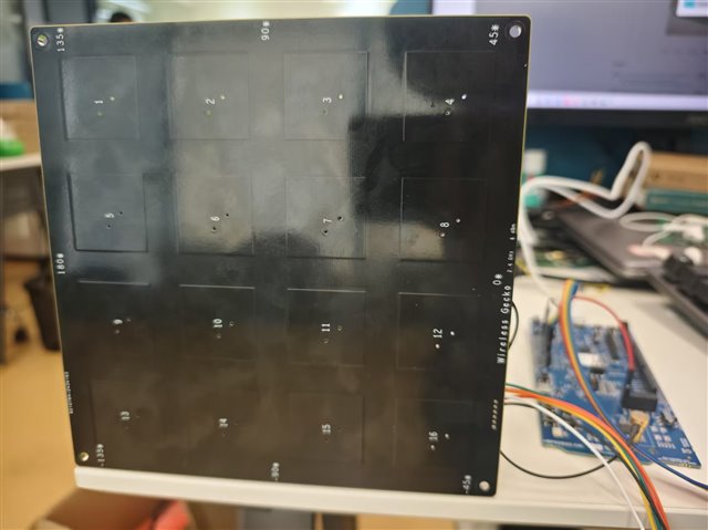

    So these are the completely default samples from the NCS SDK?
    Are you using an antenna matrix too?
    Elfving

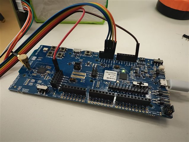

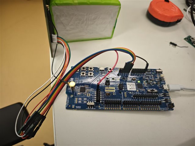

  • 你好,我使用的是16阵源天线矩阵,使用的是官方示例,使用的是NCS SDK3.3版本。
    Hello, I'm using a 16-element antenna array with the official example and NCS SDK version 3.3.
  • Understood. That is what I use as well. And you have connected the antenna array to the rx/locator device using the SWF antenna connector?
    What you are seeing here is similar to what I see when I haven't connected the antenna to the DK, so that is my first assumption as to what is wrong here. Another problem, though, could be whether the right configuration is used on the 5340, although I think this should happen automatically.
