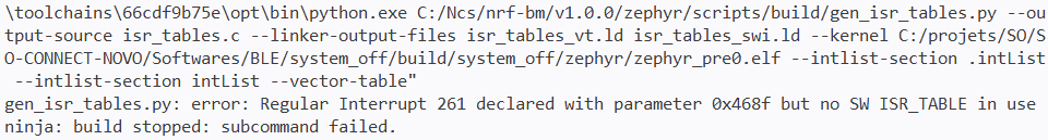

Application ble_nus works fine.
Now we want to test power down mode and wakeup by gpio function.
Application system_off gives us an example. But the application can not compile in Bare Metal environnement.
I don't know why.
The goal is to integrate power down mode and wakeup by gpio function in the ble_nus application.

This does not compile, because there is no gpio referenced in the Device Tree generated by the build.
So my question is : how can I activate gpios in the Device tree and why they are not activated with CONFIG_GPIO=y ?
