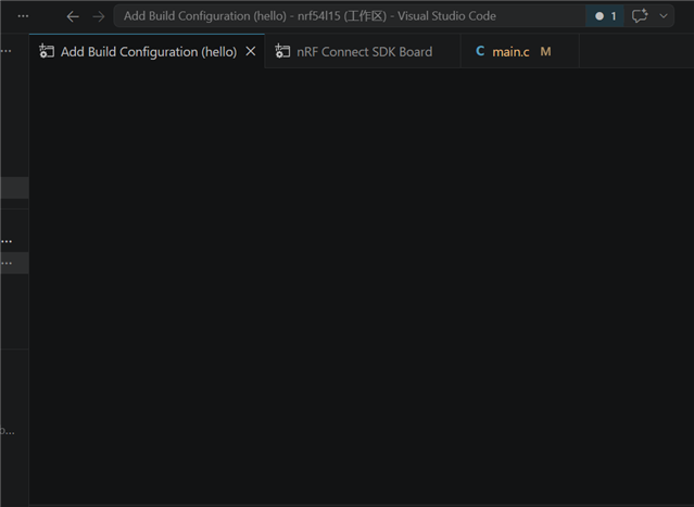

The VS Code extension "Add Build Configuration" displays a blank screen.
Both the SDK and toolchain are version 3.3.0

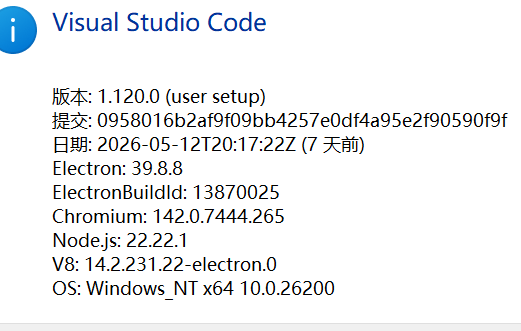

NRF Connect for VS Code plugin version

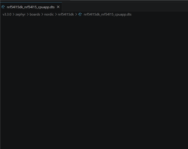

  • I found that the device tree plug-in also failed to display visual information

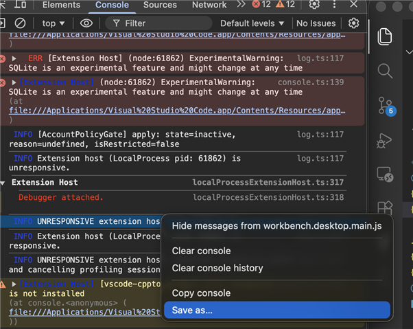

  • Our team asks if you can provide some information from the extension by doing the following:
    Start developer tools from the Command Palette
    Then save the information and share with us:

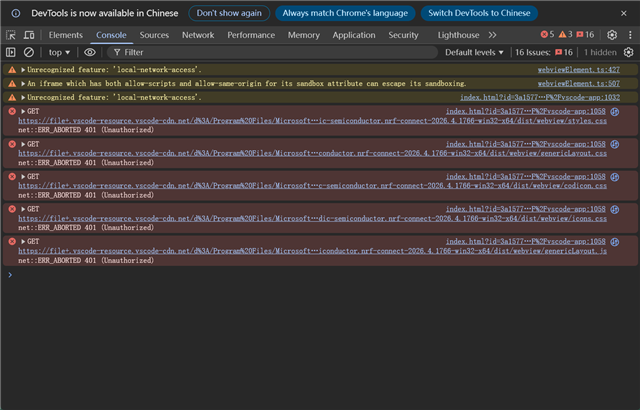

  • This is the log from when I clicked Add build configuration. I'm not sure if this is what you need. If it's incorrect, please let me know and I'm happy to cooperate
  • webviewElement.ts:427 Unrecognized feature: 'local-network-access'.

    webviewElement.ts:507 An iframe which has both allow-scripts and allow-same-origin for its sandbox attribute can escape its sandboxing.

    This is the log of the visualization failure when I click the Device Tree plugin
    _createElement @ webviewElement.ts:427
    ij @ webviewElement.ts:201
    gje @ webviewElement.ts:56
    _createInstance @ instantiationService.ts:162
    createInstance @ instantiationService.ts:128
    createWebviewElement @ webviewService.ts:13
    _show @ overlayWebview.ts:207
    claim @ overlayWebview.ts:145
    claim @ webviewEditorInput.ts:165
    claimWebview @ webviewEditor.ts:164
    setInput @ webviewEditor.ts:158
    mountTo @ webviewElement.ts:507
    _show @ overlayWebview.ts:232
    log.ts:117  INFO Extension host (LocalProcess pid: 19292) is unresponsive.
    localProcessExtensionHost.ts:317 Extension Host
    localProcessExtensionHost.ts:318 Debugger attached.
    log.ts:117  INFO UNRESPONSIVE extension host: starting to profile NOW
    log.ts:117  INFO Extension host (LocalProcess pid: 19292) is responsive.

  • Hello, and thanks for providing this information.
    Our team are concerned that some of this issue might be related to chinese characters in the path, e.g. F:\\code\\[USERNAME]
    That said, the support information shows that there are several Windows paths in use, i.e. C:\, F:\, and D:\ which we suspect could potentially cause an issue. Here are some potential work-arounds for the issue, suggested by our team. Please not that the last one is destructive, but the idea would be to start from a clean(er) environment.
    • Check and remove if VSCODE_EXTENSIONS environment variable is set, that changes where extensions are installed
    • Check and correct if there's any global user settings that changes the location where extensions are installed
    • Delete %APPDATA%/code in this case it's probably C:\\Users\\[USERNAME]\\AppData\\Code
    Let me know how this works for you.
    Øyvind
  • I did change the default installation location of extensions. Since I didn’t want to install all extensions on drive C, I installed them on drive D instead, and created a symbolic link in the default extensions directory pointing to the installation location on drive D.
    For example: mklink /D linkDir targetDir
    Is there a way to restore the correct use of extensions without further modification?
    Unfortunately, this is not something we can help with and beyond our scope.
    Øyvind
