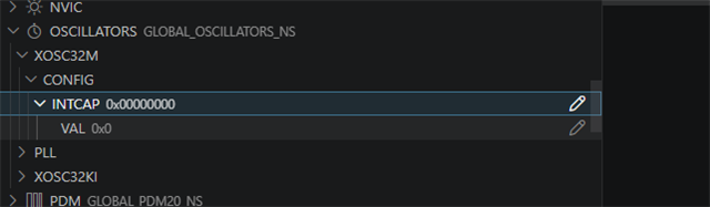

I can see crystal is launched here :
internal oscillator is not configured
we use sdk 2.9.0 so i tried with 3.2.3 sdk version.
The results are not the same. I have got response even with -40 ° but still errors at - 18°.
There is a big difference between 2.9.0 and 3.2.3, crystal is not running:
