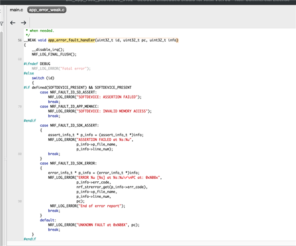

    Could you please try to provide any more details about this crash? If you have debug logging available on this device, the easiest way to get more information about the crash is to build the project with "DEBUG" defined in the list of preprocessor symbols and let the app_error_fault_handler() print the crash log.
