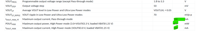

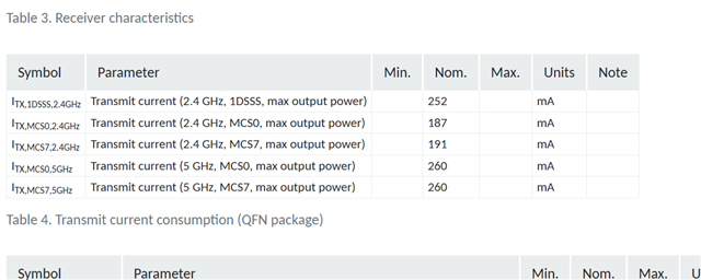

Questions for the Engineering Team
  1. Is this a known erratum/behavior?
    Can the ADC-block registers (and ADC.STATUS) NACK if the boost regulator is supplying heavy transient currents to a load like the nRF7002? We found no mention of this in the v1.0 datasheet or official FAQ blogs.
  2. What is the recommended software workaround under heavy load?
    Would leveraging the hardware interrupt via EVENTS_ADC_SET.VBATRDY be more robust than polling STATUS, considering the STATUS register itself gets NACK'd?
  3. What hardware modifications do you recommend to stiffen VOUT?
    To mitigate nRF7002 TX bursts, should we look at increasing the VOUT capacitance, changing the boost operating mode, or other layout/decoupling adjustments?
