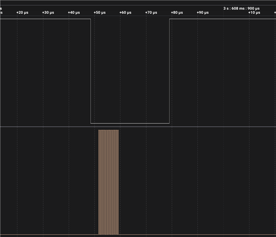

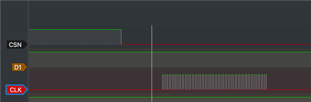

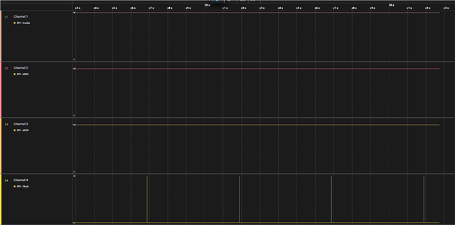

    Thank you for the response. To clarify, the flash is not my primary concern. the issue is that SPIM00 is not working at all with the defined pins on P2. CSN never asserts low during a transfer, and there is no activity on SCK or MOSI, even though spi_transceive returns 0 (success).
    To make it easy to reproduce without any custom hardware, I have prepared a minimal test project that can be run directly on the nRF54L15 DK with a logic analyser attached to the following pins:
    SCK : P2.6
    MOSI : P2.2
    MISO : P2.4
    CSN : P2.5
    The test sends a repeating 0xAA 0x55 pattern every 5 seconds so the activity is easy to spot on a logic analyser.
    attached firmware for testing.
