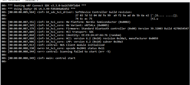

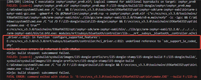

Enabling coded broadcast compilation may result in undefined coded parameters, and coded scanning may also generate errors. May I know which SDK version will support these related features?

Coded PHY is not yet supported on nRF54LS05B. See here: https://docs.nordicsemi.com/bundle/ncs-latest/page/nrf/releases_and_maturity/software_maturity.html#bluetooth_features_support
For any information on future plans and timelines, you will need to get in touch with the Sales Team. Please contact your Regional Sales Manager to know when it will be supported. If you need the contact information of your RSM, do let me know.
