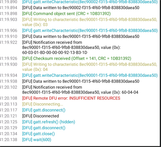

I am currently developing UART communication firmware for the nRF52805, but I am encountering issues with performing DFU firmware updates.
Below are the details of the situation:
I built the bootloader using the DFU Bootloader project located at: examples/dfu/secure_bootloader/pca10040e_s112_ble in nRF5 SDK (v17.1.0).
I then programmed the Bootloader.hex together with the SoftDevice (s112_nrf52_7.3.0_softdevice.hex) into the nRF52805 using J-Link via the nRF Connect for Desktop Programmer. After programming, I can confirm that the module is advertising as "DfuTarg" in the nRF Connect for Mobile app on an Android device.
Next, I generated a signed DFU package using the following command in the examples/dfu folder, and transferred the generated .zip file to the Android device: nrfutil pkg generate --hw-version 52 --sd-req 0x126 --application-version 1 --application ble_app_uart_pca10040e_s112.hex --key-file priv.pem ble_app_uart_pca10040e_s112.zip
Then, on the Android device (nRF Connect for Mobile app), I tap "Connect (DFU)" and select the transferred ble_app_uart_pca10040e_s112.zip. The DFU transfer starts briefly, but then immediately disconnects, and the firmware is not transferred. Could you please advise what might be causing this issue?
Additional information:
I am basically following the procedure described in the following guide:
https://devzone.nordicsemi.com/guides/short-range-guides/b/software-development-kit/posts/nrf5-sdk-v17-1-0-secure-dfu-hands-on-tutorial-for-the-nrf52810#mcetoc_1g056tscv0
I have already confirmed the FW ID for S112 v7.3.0 using: nrfutil nrf5sdk-tools pkg generate --help (s112_nrf52_7.3.0 | 0x126)
The error log from the Android device is as follows:
Regarding the nRF52805, I understand certain limitations (such as memory size), and I believe that my bootloader firmware and application firmware meet these constraints. However, my understanding may be incorrect.

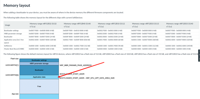

<nRF52805 Memory map>
0x00000000 MBR
0x00001000 SoftDevice (S112)
0x00019000 App
0x00028000 Bootloader
0x0002E000 MBR params page
0x0002F000 Bootloader settings

  • Thank you for the fast response.
    Yes, as you pointed out, I am using FDS. As you suggested, reducing the firmware size resolved the error, and the DFU process now works correctly.I was not aware that the FDS usage is included in NRF_DFU_APP_DATA_AREA_SIZE, so I had assumed that the application firmware size itself was within acceptable limits. It also appears that this is not reflected in the "app_size : xxxxx" output from the "nrfutil pkg display APP-FWxxx.zip" command.
    In any case, I sincerely appreciate your accurate and helpful advice.
