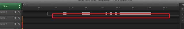

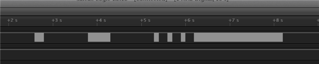

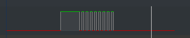

PWM can't output low level when it is idle.
    ncs v3.2.0,nRF54LM20-DK,I drive a buzzer. When the buzzer doesn't ring, I need a low level. I tried it according to the following method. I can't output a low level when pwm is idle.
①Change PWM_POLARITY_NORMAL to PWM_POLARITY_INVERTED,Pwm can't output low when it is idle.
②nrf_pwm_channel_idle_set(NRF_PWM21, 0, false);Pwm can't output low when it is idle.
③void buzzer_off(void)   function i had try
pwm_set_dt(&buzzer_pwm, PWM_PERIOD_2_7KHZ_NS, PWM_PERIOD_2_7KHZ_NS );  and  pwm_set_dt(&buzzer_pwm, PWM_PERIOD_2_7KHZ_NS, 0);Pwm can't output low when it is idle.
