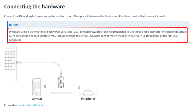

As part of the Bluetooth LE course we need to setup and install the nRF BLE sniffer for wireshark. I have followed the explained steps in the course to set up wireshark to sniff bluetooth packets. In one of the steps you need to open wireshark and select the nRF Sniffer for Bluetooth LE interface to sniff packets. I do not see that interface in my wireshark.
Just for good measure I reinstalled wireshark and made sure to set up the plugin bootstrap again. I have also made sure the directory of extcap in wireshark is indeed the same as the nrfutil expects. I have also made sure that the files that were suppose to be placed by the bootstrap command of nrfutil were indeed in the extcap folder: nrfutil-ble-sniffer-hci-shim, nrfutil-ble-sniffer-shim, nrfutil-ble-sniffer-shim-config.json.
Manually running the nrfutil-ble-sniffer-shim returns this output:
./nrfutil-ble-sniffer-shim --extcap-interfaces
thread 'main' (24508) panicked at src/main.rs:1953:68:
called `Option::unwrap()` on a `None` value
note: run with `RUST_BACKTRACE=1` environment variable to display a backtrace
Error: Subprocess /home/david/.nrfutil/bin/nrfutil-ble-sniffer failed with unexpected exit code Some(101)
I don't know what am I doing wrong.

But later it shows that the nRF52 DK is also supported:
Development kit/dongle Firmware file name
nRF52840 DK sniffer_nrf52840dk_nrf52840_*.hex
nRF52840 Dongle sniffer_nrf52840dongle_nrf52840_*.zip
nRF52833 DK sniffer_nrf52833dk_nrf52833_*.hex
nRF52 DK sniffer_nrf52dk_nrf52832_*.hex
I am using the nRF52 DK for sniffing and I don't have a different alternative right now so that also has me a bit worried that it could be the issue.
