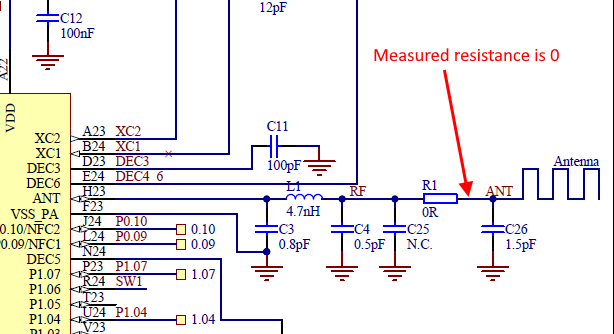

I had a look at the dongle board and there is one thing that I am not sure of. I measured resistance between R0 (antenna input) and the ground - see the picture below. The resistance is 0 Ohms. Since there are only capacitors that are connected to the ground from the antenna to the IC pin, I don't know why the resistance is 0.  Unless there is something internal (inductor) inside that chip that would create this value.
Could anyone advise what resistance should I expect at this point? If 0 Ohms resistance is correct what else can be the problem with the radio?

    There is an inductor internally, connected to ground, so measuring 0 ohm (or close to), is expected on the ANT pin.
