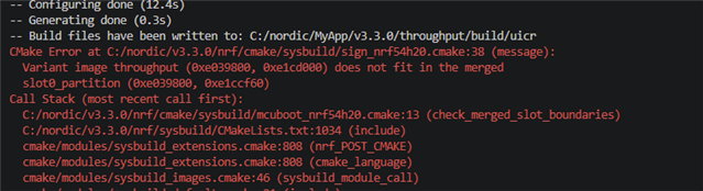

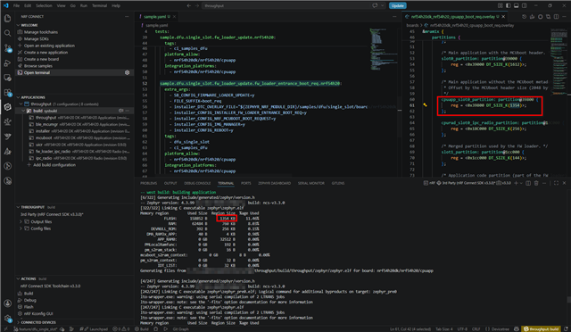

    I tried to build the sample you provided throughput_dfu_single_slot but got the following error:
    Do you have anything else need to be set or include when building ?

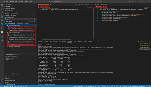

  • Hi Hung,
    I tried with peripheral_uart, and the behavior changed similarly to the throughput example when adding DFU single_slot.
    8623.peripheral_uart.zip
    1. build_app_only.bat – This build includes only the app and netcore. The log is shown below.
    1.1 Build
    D:\ncs\v3.3.0\peripheral_uart>build_app_only.bat
    D:\ncs\v3.3.0\peripheral_uart>west build -d build_app_only -b nrf54h20dk/nrf54h20/cpuapp
    1.2 Log

    2. build_boot_req.bat – This build integrates single_slot as well. The log is shown below.
    In this build, I used the dfu_application.zip file to update. The file size is ~1.5MB, similar to the app and netcore image merge strategy, and the update was successful. However, the log for the IPC radio image differs from build_app_only.
    2.1 Build
    west build -b nrf54h20dk/nrf54h20/cpuapp -T ./sample.dfu.single_slot.fw_loader_update.fw_loader_entrance_boot_req.nrf54h20
    Or
    D:\ncs\v3.3.0\peripheral_uart>build_boot_req.bat
    D:\ncs\v3.3.0\peripheral_uart>west build -d build_boot_req -b nrf54h20dk/nrf54h20/cpuapp --sysbuild -- -DSB_CONFIG_FIRMWARE_LOADER_UPDATE=y -DFILE_SUFFIX=boot_req -Dinstaller_DTC_OVERLAY_FILE="${ZEPHYR_NRF_MODULE_DIR}/samples/dfu/single_slot/boards/nrf54h20dk_nrf54h20_cpuapp_boot_req.overlay" -Dinstaller_CONFIG_INSTALLER_FW_LOADER_ENTRANCE_BOOT_REQ=y -Dinstaller_CONFIG_NRF_MCUBOOT_BOOT_REQUEST=y -Dinstaller_CONFIG_IMG_MANAGER=y -Dinstaller_CONFIG_REBOOT=y
