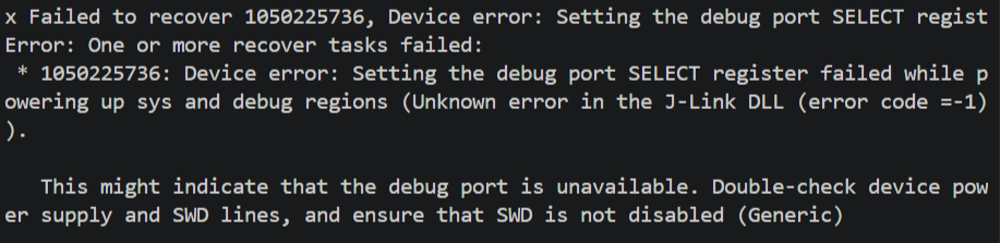

When I try to recover the board to remove APPROTECT, both nrfutil and nrfjprog fail. For example:
nrfjprog --recover -f NRF52 --snr 1050225736 --clockspeed 100
The output includes repeated SEGGER backend errors and then:
Recovering device. This operation might take 30s.
[error] [ Client] - Encountered error -21: Command recover executed for 446 milliseconds with result -21
[error] [ Worker] - An unknown error.
ERROR: Recover failed. Please make sure that the correct device family is given
ERROR: and try again.
I also tried lower SWD clock speeds:
nrfjprog --recover -f NRF52 --snr 1050225736 --clockspeed 50
The failures are similar.

  • Hi Vie,
    Check the power supply levels with the multimeter most of the time that is the issue.
    SWDIO at 3.03 V confirms that line gets to the chip, SWDCLK at 0 V is just its idle state and shows no useful info.
    Can you scope SWDCLK at the module pad during
    --recover to confirm it actually toggles there. If it does, then there has to be something wrong with the module? Try with atleast another module as well to see if this is a issue with the test setup of if that single module is somehow broken or bricked.
