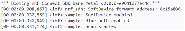

Application ble_nus central. starts :
We want to detect a hardware device with nRF52832 stack. But the device is not discovered.
This hardware device is correcty detected in a nRF52832 environnement.

The device is still not discovered.
So, what can be the problem ? Why the nRF54L15 stack does discover nothing ?

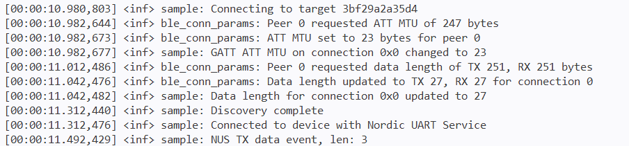

  • Hi, it works !
    I made this changes in main code :
    static struct ble_scan_filter_data uuid_filter = {
            .uuid_filter = {.uuid = {.uuid = BLE_UUID_NUS_SERVICE, .type = BLE_UUID_TYPE_BLE}}}; // Not a const structure
    and in scan_init() :
        uuid_filter.uuid_filter.uuid.type = ble_nus_client.uuid_type;
        nrf_err = ble_scan_filter_add(&ble_scan, BLE_SCAN_UUID_FILTER, &uuid_filter);
        if (nrf_err) {
            LOG_ERR("nrf_ble_scan_filter_add uuid failed, nrf_error %#x", nrf_err);
            return nrf_err;
    And then my device is discovered :
    Thanks a lot.
