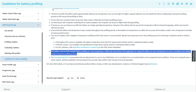

our customer are making the batterie profile by using NPM-FG , by profile logging , it was all fine by testing under low temperature and room temperature
but by testing with 45C, it always has warning for temperature too high and the charging is stopped, if we down the temp to 42-43 C it could charge normally again.
but due to the request , it  should be tested under 45C , is any recommend method, that can allow our customer to keep testing under 45 C ?
