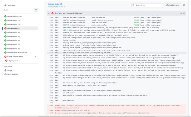

  • Hello Zephyr Community,
    First of all please private this thread because i am sharing critical info about my contribution and here
    I am trying to contribute a new sensor driver for the AMS AS7341 Spectral Sensor to Zephyr (using NCS v3.2.2 / Zephyr), and I would appreciate some guidance regarding CI/Twister failures during the contribution process.
    Environment
    • NCS Version: v3.2.2
    • Target Hardware: nRF9151
    • Driver: AMS AS7341 Spectral Sensor
    • Driver implemented using Zephyr Sensor API:
      • sample_fetch()
      • channel_get()
      • attr_set()
      • attr_get()
      • Trigger support APIs
    Driver Integration
    I added the driver under:
    zephyr/drivers/sensor/ams/ams_as7341/
    Files:
    ams_as7341.c
    ams_as7341.h
    Kconfig
    CMakeLists.txt
    I also updated:
    zephyr/drivers/sensor/ams/Kconfig
    zephyr/drivers/sensor/ams/CMakeLists.txt
    to include the new driver.
    Devicetree Binding
    Added:
    zephyr/dts/bindings/sensor/ams,as7341.yaml
    Content:
    # Copyright (c) 2026 Dotcom IoT LLP
    description: AMS AS7341 spectral sensor
    compatible: "ams,as7341"
    include:
      - sensor-device.yaml
      - i2c-device.yaml
    Twister Test
    Created:
    zephyr/tests/drivers/sensor/ams_as7341/
    Files:
    src/main.c
    #include <zephyr/ztest.h>
    #include <zephyr/drivers/sensor.h>
    ZTEST_SUITE(ams_as7341_tests, NULL, NULL, NULL, NULL, NULL);
    ZTEST(ams_as7341_tests, test_basic_assertions)
    	zassert_true(1, "basic assertion failed");
    CMakeLists.txt
    cmake_minimum_required(VERSION 3.20.0)
    project(ams_as7341_test)
    FILE(GLOB app_sources src/*.c)
    target_sources(app PRIVATE ${app_sources})
    prj.conf
    CONFIG_ZTEST=y
    CONFIG_SENSOR=y
    CONFIG_I2C=y
    CONFIG_AMS_AS7341=y
    testcase.yaml
    tests:
      drivers.sensor.ams_as7341:
        tags:
          - drivers
          - sensor
        platform_allow:
          - native_sim
        integration_platforms:
          - native_sim
        harness: ztest
    Local Validation
    Twister
    Executed:
    export ZEPHYR_TOOLCHAIN_VARIANT=zephyr
    export ZEPHYR_SDK_INSTALL_DIR=/home/dnk133/ncs/toolchains/927563c840/opt/zephyr-sdk
    ~/ncs/v3.2.2/zephyr/scripts/twister \
        -T tests/drivers/sensor/ams_as7341 \
        -p native_sim \
        -v
    Result:
    PASS
    Checkpatch
    Executed:
    ./scripts/checkpatch.pl --file drivers/sensor/ams/ams_as7341/ams_as7341.c
    ./scripts/checkpatch.pl --file drivers/sensor/ams/ams_as7341/ams_as7341.h
    ./scripts/checkpatch.pl --file drivers/sensor/ams/ams_as7341/Kconfig
    ./scripts/checkpatch.pl --file drivers/sensor/ams/ams_as7341/CMakeLists.txt
    ./scripts/checkpatch.pl --file dts/bindings/sensor/ams,as7341.yaml
    Result:
    No checkpatch errors reported
    CI Failure
    However, after creating the pull request, CI fails during the Twister build stage.
    From the CI log, I see errors similar to:
    error: as7341_init defined but not used [-Werror=unused-function]
    and multiple failures such as:
    drivers.sensor.generic_test
    drivers.sensor.no_default
    drivers.sensor.pm
    drivers.sensor.trigger.own
    The failure seems to occur on the native_sim/native build configurations.
    Screenshot attached below for reference.
    My Questions
    1. Why does the driver pass local Twister testing but fail in Zephyr CI?
    2. Is as7341_init() expected to be conditionally compiled using a DT_INST macro?
    3. Could the failure be caused by:
      • Missing DT_INST_FOREACH_STATUS_OKAY() usage?
      • Missing device instantiation macros?
      • Missing Kconfig dependencies?
      • Driver being compiled even when no AS7341 instance exists in the build?
    4. Are there additional sensor-driver tests that must be added beyond a simple ZTest application?
    5. Is there any recommended checklist for contributing a new sensor driver to Zephyr/NCS?
    Any suggestions on what I should inspect next would be greatly appreciated.
    Thank you for your time and guidance.
    Best Regards,
    Milan Pipaliya
