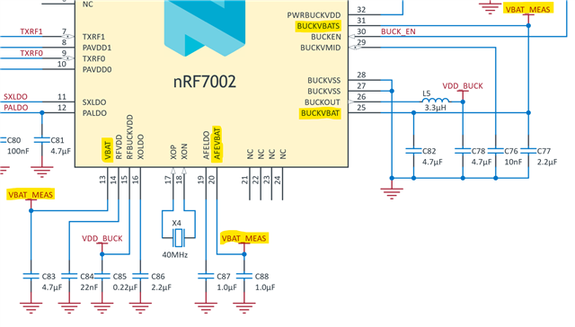

Hi Nordic team,
We are designing a custom board using an nRF54L15 together with an nRF7002 WLCSP.
Our board has a single 3.3 V power rail. We would like to confirm the correct power connection for the nRF7002 WLCSP supply pins.
Should the following pins be connected directly to our 3.3 V rail, assuming they are all power input pins?
  • VBAT
  • AFEVBAT
  • BUCKVBAT
  • BUCKVBATS
Could you please confirm whether these pins can all be tied to the same 3.3 V supply, or if any of them require a different connection, filtering, sequencing, or decoupling arrangement?
We are also checking the nRF54L15 + nRF7002 compact reference design, but we would appreciate confirmation for our custom board implementation.
