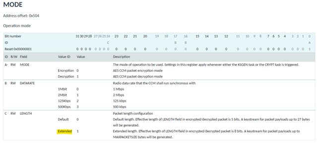

    Does the nRF52832 support CCM_MODE_LENGTH_Extended mode?
    Yes, see the nRF52832 Product Specification/the CCM register: CCM.MODE.LENGTH

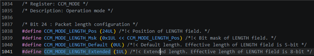

    nRF5_sDK\modules\nrfx\mdk\nrf52_bitfields.h:
    If so, are there any documents or sample codes that demonstrate how to use CCM Extended mode on the nRF52832?
    Unfortunately, there are no such resources as you request.

    From my research, it seems that the MAXPACKETSIZE register/parameter may need to be adjusted when using Extended mode. Unfortunately, I cannot find any reference to MAXPACKETSIZE in the nRF52832 product specification.
    Could you please clarify:
    1. How should MAXPACKETSIZE be configured when using CCM_MODE_LENGTH_Extended on nRF52832?
    2. If MAXPACKETSIZE is not exposed in nRF52832, what is the recommended way to avoid decode errors in Extended mode?
