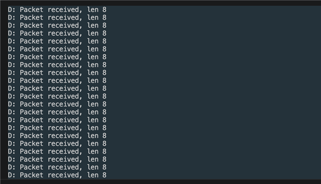

    Using your exact code on the nRF54840DK, I do not see the issue you are seeing
  • Hi, likewise sorry for the late response this time.
    Are you trying this on a devkit? And are you using probe-rs, or something else? Those are the only differences I can think of between our setups.
    This is not completely blocking my development right now since I can always reset the chip, so if we can't reliably reproduce this elsewhere I'm fine with just dropping it and using workarounds myself.
  • I just tried this on two nRF54840DKs (one for rx and the other for tx). I am not using any probles, just simple flash and test on the serial output.
