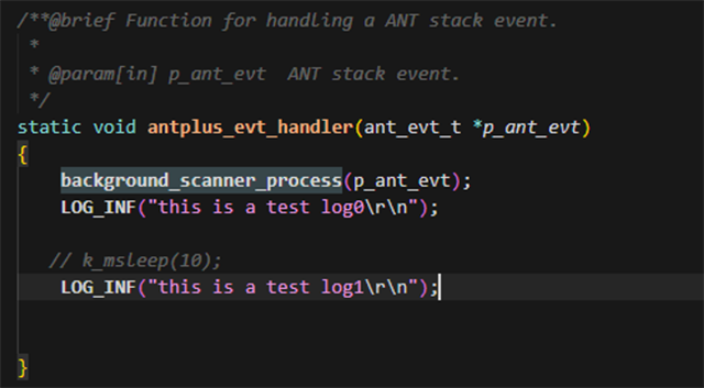

Hi
I'm encountering a problem than the ANT device cannot be scanned. you can use project "ble_ant_app_hrm_v324"(ncs 324), and modify "
light_rx_open_head" to connect to your ant device, you will see the error "0x4015", and ant device cannot be scanned anymore. And, I use that project "ble_ant_app_hrm_v292" run with ncs 292(test code is same with "ble_ant_app_hrm_v324"), it does't report error.
Plase help me solve this issue. Thanks.

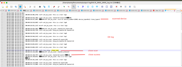

    [06/01/2026 14:30:13.976] [00:00:00.623,435] <inf> hrm_relay: scan 0
    [06/01/2026 14:30:13.976] [00:00:00.624,416] <inf> hrm_relay: start scan
    [06/01/2026 14:30:13.976] [00:00:00.625,454] <inf> ant_bs_scan: bs_scan_open len=0 channel_status=0x1
    [06/01/2026 14:30:14.133] [00:00:00.794,117] <inf> ant_bs_scan: channel=0 event=128
    [06/01/2026 14:30:14.133] [00:00:00.795,431] <inf> ant_bs_scan: rssi=-86 device_number=18818 device_type=0x7f trans_type=5
    [06/01/2026 14:30:14.133] [00:00:00.797,406] <inf> ant_bs_scan: this is a test log0
    [06/01/2026 14:30:14.141] [00:00:00.808,753] <inf> ant_bs_scan: this is a test log1
    [06/01/2026 14:30:14.142] m
    [06/01/2026 14:30:14.493] [00:00:01.160,737] <inf> ant_bs_scan: channel=0 event=128
    [06/01/2026 14:30:14.498] [00:00:01.162,050] <inf> ant_bs_scan: rssi=-73 device_number=23081 device_type=0xb trans_type=5
    [06/01/2026 14:30:14.499]
    [06/01/2026 14:30:14.499] [00:00:01.164,009] <inf> ant_bs_scan: this is a test log0
    [06/01/2026 14:30:14.514] [00:00:01.175,356] <inf> ant_bs_scan: this is a test log1
    [06/01/2026 14:30:14.515]
    [06/01/2026 14:30:14.783] [00:00:01.450,071] m<inf> ant_bs_scan: channel=0 event=128
    [06/01/2026 14:30:14.787] [00:00:01.451,386] <inf> ant_bs_scan: rssi=-43 device_number=62717 device_type=0x24 trans_type=70
    [06/01/2026 14:30:14.791]
    [06/01/2026 14:30:14.791] [00:00:01.453,380] <inf> ant_bs_scan: this is a test log0
    [06/01/2026 14:30:14.797] [00:00:01.464,727] m<inf> ant_bs_scan: this is a test log1
    [06/01/2026 14:30:14.800]
    [06/01/2026 14:30:15.281] [00:00:01.932,613] <inf> ant_bs_scan: channel=0 event=128
    [06/01/2026 14:30:15.282] [00:00:01.933,927] <inf> ant_bs_scan: rssi=-43 device_number=62717 device_type=0x23 trans_type=69
    [06/01/2026 14:30:15.282] [00:00:01.935,921] <inf> ant_bs_scan: this is a test log0
    [06/01/2026 14:30:15.285] [00:00:01.947,268] <inf> ant_bs_scan: this is a test log1
    [06/01/2026 14:30:15.390] [00:00:02.057,245] m<inf> ant_bs_scan: channel=0 event=128
    [06/01/2026 14:30:15.394] [00:00:02.058,560] <inf> ant_bs_scan: rssi=-43 device_number=62717 device_type=0x23 trans_type=69
    [06/01/2026 14:30:15.398]
    [06/01/2026 14:30:15.398] [00:00:02.060,555] <inf> ant_bs_scan: this is a test log0
    [06/01/2026 14:30:15.404] [00:00:02.071,903] <inf> ant_bs_scan: this is a test log1
    [06/01/2026 14:30:15.405] m
    [06/01/2026 14:30:15.406]
    [06/01/2026 14:30:15.902] [00:00:02.569,140] <inf> ant_bs_scan: channel=0 event=128
    [06/01/2026 14:30:15.908] [00:00:02.570,454] <inf> ant_bs_scan: rssi=-72 device_number=23081 device_type=0x11 trans_type=5
    [06/01/2026 14:30:15.910]
    [06/01/2026 14:30:15.910] [00:00:02.572,429] <inf> ant_bs_scan: this is a test log0
    [06/01/2026 14:30:15.916] [00:00:02.583,776] <inf> ant_bs_scan: this is a test log1
    [06/01/2026 14:30:15.917]
    [06/01/2026 14:30:16.152] [00:00:02.819,139] m<inf> ant_bs_scan: channel=0 event=128
    [06/01/2026 14:30:16.154] [00:00:02.820,452] <inf> ant_bs_scan: rssi=-67 device_number=23081 device_type=0x11 trans_type=5
    [06/01/2026 14:30:16.155]
    [06/01/2026 14:30:16.155] [00:00:02.822,428] <inf> ant_bs_scan: this is a test log0
    [06/01/2026 14:30:16.167] [00:00:02.833,775] <inf> ant_bs_scan: this is a test log1
    [06/01/2026 14:30:16.404] [00:00:03.070,302] <inf> ant_bs_scan: channel=0 event=128
    [06/01/2026 14:30:16.409] [00:00:03.071,615] <inf> ant_bs_scan: rssi=-43 device_number=62717 device_type=0x24 trans_type=70
    [06/01/2026 14:30:16.412]
    [06/01/2026 14:30:16.412] [00:00:03.073,610] <inf> ant_bs_scan: this is a test log0
    [06/01/2026 14:30:16.417] [00:00:03.084,960] <inf> ant_bs_scan: this is a test log1
    [06/01/2026 14:30:16.422]
    [06/01/2026 14:30:16.741] [00:00:03.407,969] <inf> ant_bs_scan: channel=0 event=128
    [06/01/2026 14:30:16.742] [00:00:03.409,282] <inf> ant_bs_scan: rssi=-64 device_number=23081 device_type=0xb trans_type=5
    [06/01/2026 14:30:16.748]
    [06/01/2026 14:30:16.748] [00:00:03.411,240] <inf> ant_bs_scan: this is a test log0
    [06/01/2026 14:30:16.755] [00:00:03.422,587] <inf> ant_bs_scan: this is a test log1
    [06/01/2026 14:30:16.757]

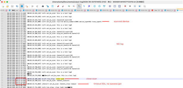

    [06/01/2026 14:30:16.960] [00:00:03.627,281] <inf> hrm_relay: open light head
    [06/01/2026 14:30:16.963] [00:00:03.628,445] <inf> ant_bs_scan: light_rx_open ch=13 dev=62717 type=35 tran=69
    [06/01/2026 14:30:17.010] [00:00:03.677,474] <inf> ant_bs_scan: channel=13 event=128
    [06/01/2026 14:30:17.011] [00:00:03.678,810] <inf> ant_bs_scan: disp_evt_handler=0 channel=13
    [06/01/2026 14:30:17.012] m
    [06/01/2026 14:30:17.012] [00:00:03.680,262] <inf> ant_bs_scan: this is a test log0
    [06/01/2026 14:30:17.017]
    [06/01/2026 14:30:17.024] [00:00:03.691,610] <inf> ant_bs_scan: this is a test log1
    [06/01/2026 14:30:17.025]
    [06/01/2026 14:30:17.135] [00:00:03.802,099] <inf> ant_bs_scan: channel=13 event=128
    [06/01/2026 14:30:17.138] [00:00:03.803,421] <inf> ant_bs_scan: disp_evt_handler=0 channel=13
    [06/01/2026 14:30:17.143]
    [06/01/2026 14:30:17.143] [00:00:03.804,873] <inf> ant_bs_scan: this is a test log0
    [06/01/2026 14:30:17.148] [00:00:03.816,221] <inf> ant_bs_scan: this is a test log1
    [06/01/2026 14:30:17.149] m
    [06/01/2026 14:30:17.264] [00:00:03.926,733] <inf> ant_bs_scan: channel=13 event=128
    [06/01/2026 14:30:17.264] [00:00:03.928,053] <inf> ant_bs_scan: disp_evt_handler=0 channel=13
    [06/01/2026 14:30:17.264] [00:00:03.929,506] <inf> ant_bs_scan: this is a test log0
    [06/01/2026 14:30:17.273] [00:00:03.940,854] <inf> ant_bs_scan: this is a test log1
    [06/01/2026 14:30:17.274]
    [06/01/2026 14:30:17.394] [00:00:04.051,359] <inf> ant_bs_scan: channel=13 event=128
    [06/01/2026 14:30:17.394] [00:00:04.052,668] <inf> ant_bs_scan: disp_evt_handler=0 channel=13
    [06/01/2026 14:30:17.394] [00:00:04.054,258] <inf> ant_bs_scan: this is a test log0
    [06/01/2026 14:30:17.398] [00:00:04.065,652] <inf> ant_bs_scan: this is a test log1
    [06/01/2026 14:30:17.399]
    [06/01/2026 14:30:17.511] [00:00:04.175,993] <inf> ant_bs_scan: channel=13 event=128
    [06/01/2026 14:30:17.511] [00:00:04.177,304] <inf> ant_bs_scan: disp_evt_handler=0 channel=13
    [06/01/2026 14:30:17.519]
    [06/01/2026 14:30:17.519] [00:00:04.178,829] <inf> ant_bs_scan: this is a test log0

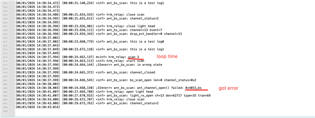

    [06/01/2026 14:30:37.994] [00:00:24.662,137] m<inf> hrm_relay: scan 3
    [06/01/2026 14:30:37.996] [00:00:24.663,113] <inf> hrm_relay: start scan
    [06/01/2026 14:30:37.996] [00:00:24.664,144] ;31m<err> ant_bs_scan: in wrong state
    [06/01/2026 14:30:37.999]
    [06/01/2026 14:30:37.999] [00:00:24.665,372] <inf> ant_bs_scan: channel_closed
    [06/01/2026 14:30:37.999] [00:00:24.666,545] <inf> ant_bs_scan: bs_scan_open len=0 channel_status=0x2
    [06/01/2026 14:30:38.003]
    [06/01/2026 14:30:38.003] [00:00:24.668,150] ;31m<err> ant_bs_scan: ant_channel_open() failed: 0x4015,bs
    [06/01/2026 14:30:41.007] [00:00:27.669,788] <inf> hrm_relay: open light head
    [06/01/2026 14:30:41.007] [00:00:27.670,933] <inf> ant_bs_scan: light_rx_open ch=13 dev=62717 type=35 tran=69
    [06/01/2026 14:30:43.006] [00:00:29.672,707] <inf> hrm_relay: close scan
    [06/01/2026 14:30:43.006] [00:00:29.673,763] <inf> ant_bs_scan: channel_status=2
    [06/01/2026 14:30:43.014]

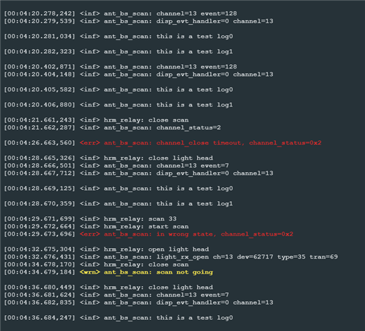

    If I remember correctly ant_channel_open() return 0x4015 means channel is in wrong state.
    Are you sure the channel is in closed state? E.g. wait for EVENT_CHANNEL_CLOSED before you open it again. When the issue occurs, what does sd_ant_channel_status_get() return?
    Kenneth
    This issue occur then I do  ant_channel_close and can't get EVENT_CHANNEL_CLOSED response. And ant_channel_status_get() always is 2.
  • Can you wait for a long period of time for test? E.g. 40seconds? I think default search time is around 30 seconds, I just want to understand if it closes at the end.
    Kenneth
  • Hi Kenneth,
     I have confirmed that when I do ant_channel_close, I can't get EVENT_CHANNEL_CLOSED even if timeout 50s. I have added the test project and test log.
