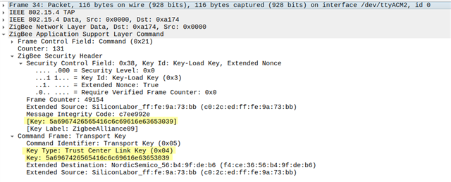

Users of our product have reported issues with multiple versions of Hubitat hubs when pairing Zigbee. I'm investigating this issue and have reached a point where I could use your help on how to proceed. I have captured Wireshark logs of the pairing process with multiple version of Hubitat hubs and they all see to fail in the same way in the TCLK Update process. So thinking something is majorly wrong with my code I tried clean Zigbee Light Switch samples from SDK versions 2.5.0, 2.7.0 and 2.9.2 and they all fail in the same way. So now I have reached a point where a clean sample build (just adding the CONFIG_ZIGBEE_CHANNEL_SELECTION_MODE_MULTI thing to prj.conf) fails with a commercially available hub and I'm not sure where to go from here.
I can share Wireshark captures if those would help. Or can you suggest something I should try to further investigate this. All the samples and my product work well with most other Zigbee controllers with no issues. So far the problem seems to specifically relate to Hubitat somehow. But I have tried other Zigbee devices with Hubitat and they seems to work fine. I have also tried contacting Hubitat developers but with little luck so far.

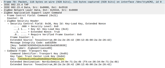

    I attached the packet capture files from both the failing Hubitat join process and a successful join to Home Assistant using a SONOFF Zigbee controller. I'm not sure if the packets are encrypted but since Claude has been able to read them I'm guessing they are not. I'm not too familiar with Zigbee so if there is something I'm doing completely wrong here I would be glad for any guidance on how to proceed.

  • Hi Tiit,
    The problem is the Trust Center Link Key used by the Hubitat coordinator. In the Transport Key packet (packet #34), the Trust Center Link Key is the same as the ZigbeeAlliance09 key. This violates the spec, which the Nordic device detects, and following the spec, it leaves the network.
    From Base Device Behavior (BDB) specificiation (v3.0.1) section 10.2.5, step 9:
    If the KeyType parameter of the received APSME-TRANSPORT-KEY.indication primitive is not equal to 0x04 (Unique Trust Center Link Key) or the link key contained in the primitive is identical to the LinkKey value of the apsDeviceKeyPairSet entry, the joining node SHALL terminate the Trust Center link key exchange procedure with a failure status.
    In the Hubitat case the KeyType is 0x04, which is correct, but the key value is identical to the device's pre-configured link key, i.e. the ZigbeeAlliance09 key.
    Why the device leaves after the failure is because of this part from section 8.2 step 12 in the BDB spec:
    The node SHALL perform the procedure for retrieving a new Trust Center link key (see sub-clause 10.2.5). If the procedure is successful, the node SHALL continue from step 14. If the procedure is not successful, the node SHALL perform a leave request on its old network and resets its network parameters. The node then sets bdbNodeIsOnANetwork to FALSE and sets bdbCommissioningStatus to TCLK_EX_FAILURE. To perform a leave request, the node issues the NLME-LEAVE.request primitive to the NWK layer with the DeviceAddress parameter set to NULL, the RemoveChildren parameter set to FALSE and the Rejoin parameter set to FALSE.
    According to the BDB spec, the Trust Center (in this case, the Hubitat ZC) must generate a new link key. Since the Hubitat ZC does not, it violates BDB spec 10.3.2 step 8:
    The Trust Center SHALL generate a link key for the node. This link key SHALL be randomly generated or be derived via a manufacturer specific algorithm, but it SHALL NOT be all zeros and it SHALL NOT be identical to the LinkKey value of the apsDeviceKeyPairSet entry corresponding to the joining node.
    If you compare with the sniffer log from the HA, you can see that it correctly generates a random unique key:
    Unfortunately, this means that there's not much we can do on our side to fix it, since the issue is that the Hubitat ZC doesn't follow the specification.
    Marte
