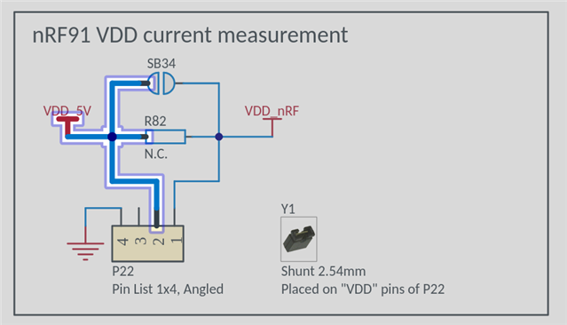

Hello Team,

Questions:
  1. Is VIN 5V on connector P20 the correct location for supplying external power to the nRF9151 DK?
  2. Are any jumpers, switches, solder bridges, or power path configurations required when powering the board through VIN 5V instead of USB?
  3. Is 4.2V sufficient for powering the complete nRF9151 DK, considering the documented 4.0V–5.5V input range?
  4. Is there a minimum startup current requirement that could prevent the board from powering up?
  5. Are there any recommended test points or measurements we should check to verify that external power is reaching the board correctly?

  • HI,
    I am not familiar with RT700 EVK but if it can deliver 5V and have sufficient current to supply then I dont see why the nRF9150DK should not be able to run. If you just want to use the nRF91 LTE part then you can power only that section as well by supplying VDGPIO and VDD_nRF separately with the correct SB cutt.
    The DK uses a nPM1300 to supply the VDD_GPIO for the nRF9151 as well as the onboard debugger.
    There should be a jumper that connects VDD_nRF to VIN_5V on P22. If not you can short SB34.
    Yes. just make sure the power switch is still "ON" and that the P22 has the jumper between VIN_5V and VDD_nRF.
    only P22 by default(it should come with the jumper), you can use SB34 or R82 as well.
    Yes this should be fine.
    You can measure on VDD_nRF to see if there is power there or not on P20 and you can check if VDD_GPIO also gets power there.
