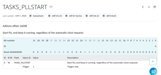

    It's good you have solved the issue.
    On the nRF54L15, after triggering the task TASKS_XOSTART, the crystal oscillator starts and the PLL automatically lock to it as reference.
    the following code cant lock to PLL
    NRF_CLOCK->TASKS_XOSTART = 1;
    while (NRF_CLOCK->EVENTS_XOSTARTED == 0) { }
    while (NRF_CLOCK->EVENTS_XOTUNED   == 0) { }
    You may try to try keeping PLL run exclusively by adding the following code
    NRF_CLOCK->TASKS_PLLSTART = 1;
    while (NRF_CLOCK->EVENTS_PLLSTARTED == 0)
    However, your first approach like changing hardware and the function my_hfclk_start() solves the issue. That seems a valid way to solve the issue.
