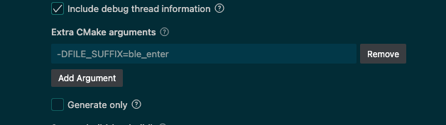

    I have created a test sample based on the single_slot sample that should support the nrf54l15dk/nrf54l05/cpuapp build target.
    single_slot.zip
    Additional build configuration to enable SMP service in the main app

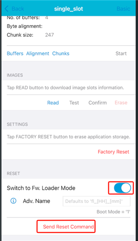

    The SMP service allows you to send the a mcumgr command to reset the device into the FW Loader application.
    Resetting into the DFU mode with the nRF Device Manager app:
    After the reset you should see the device advertising as "FW Loader" if you go back to the scanner view. You can then reconnect and complete the FW update.
