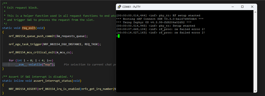

When running the example without modification, the following error messages are continuously printed on the console log:
- "rx failed error 1!" - "rx failed error 2!" - "rx failed error 9!"

  • Hi
    Okay, so I think I've found what's wrong here, and it seems to be a bug in the sample project. There is an issue with the way return values are passed back form SWI calls. As a pointer where the value will be written is pushed to the queue along with the parameters. Sometimes the value is read before it is written, resulting in issues like this.
    Our developers are working on a proper fix for this, but as a workaround for now, it should be okay to add a few "nops" after unmasking interrupts in the req_exit() function:
    static void req_exit(void)
        nrf_802154_queue_push_commit(&m_requests_queue);
        nrf_egu_task_trigger(NRF_802154_EGU_INSTANCE, REQ_TASK);
        nrf_802154_mcu_critical_exit(m_mcu_cs);
        for (int i = 0; i < 4; i++)
            __asm__ volatile("nop");
    Simon
  • Hi Simon,
    Thank you for the update and for identifying the potential bug.
    I quickly tried the workaround you suggested by adding a few "nops" after unmasking interrupts in the req_exit() function. However, unfortunately, it didn't have any effect. The exact same errors are still occurring immediately upon boot.
    Could you please let me know if there are any other workarounds or if the development team has an updated fix?
