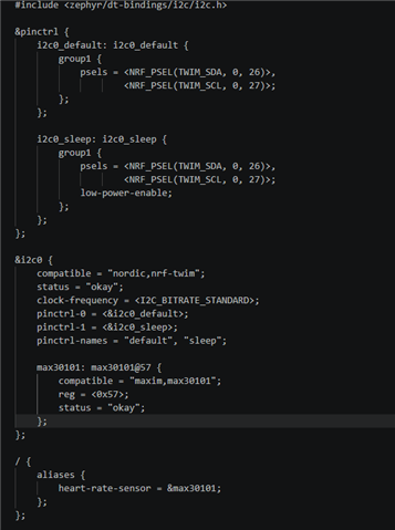

nrf52dk cannot find max30101 breakout board over i2c
I am using the heart rate sample.
I have connected ground to ground, 3.3v to vdd, SDA to pin 26 and SCL to pin 27. I have 4.7k pullup resistors on SDA and SCL. When I run i2c scan i2c0 i get:

0 devices found on i2c0
When I connect everything instead to my arduino uno (identical - only moving the wires that were in the nrf52dk to the arduino),  it correctly scans something at 0x57.

Here is my overlay, in a file named "nrf52dk_nrf52832.overlay":
#include <zephyr/dt-bindings/i2c/i2c.h>
&i2c0 {
    status = "okay";
    clock-frequency = <I2C_BITRATE_STANDARD>;
    max30101: max30101@57 {
        compatible = "maxim,max30101";
        reg = <0x57>;
        status = "okay";
    aliases {
        heart-rate-sensor = &max30101;
