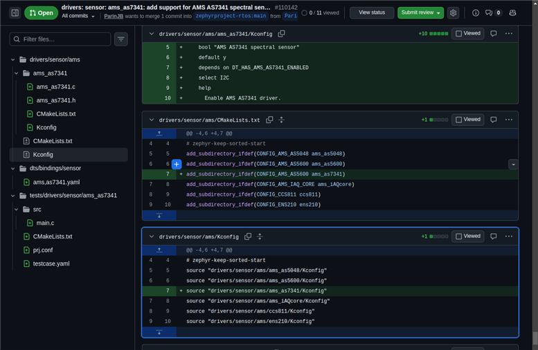

## Driver Integration
I added the driver under:
```text
zephyr/drivers/sensor/ams/ams_as7341/
Files:
```text
ams_as7341.c
ams_as7341.h
Kconfig
CMakeLists.txt
I also updated:
```text
zephyr/drivers/sensor/ams/Kconfig
zephyr/drivers/sensor/ams/CMakeLists.txt
to include the new driver.

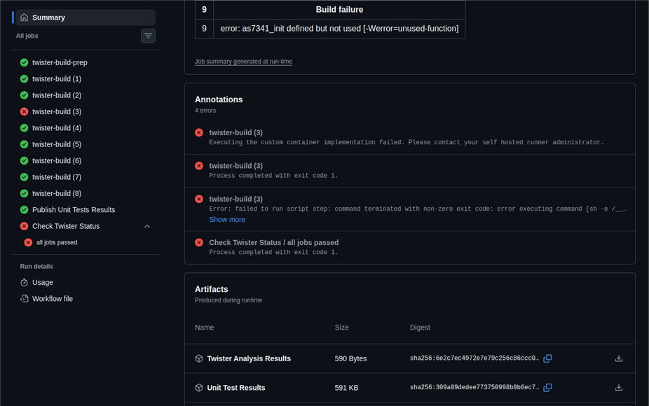

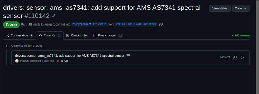

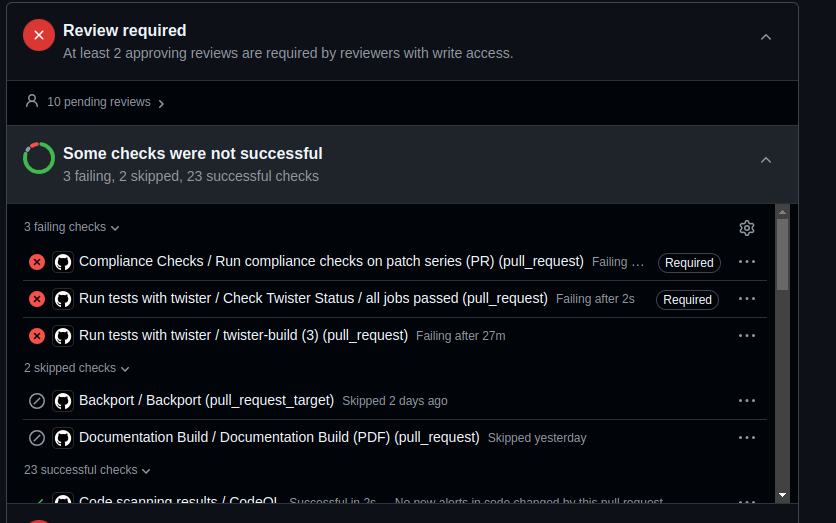

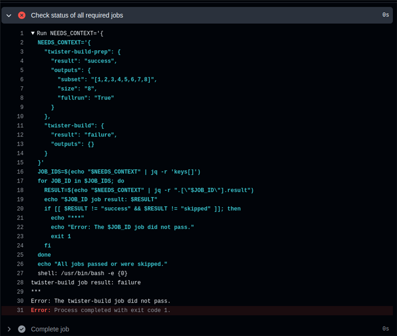

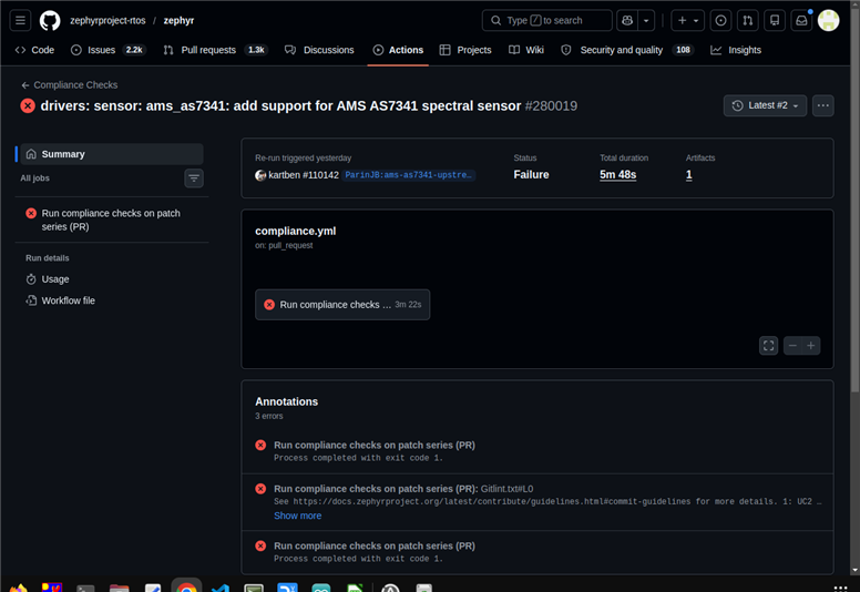

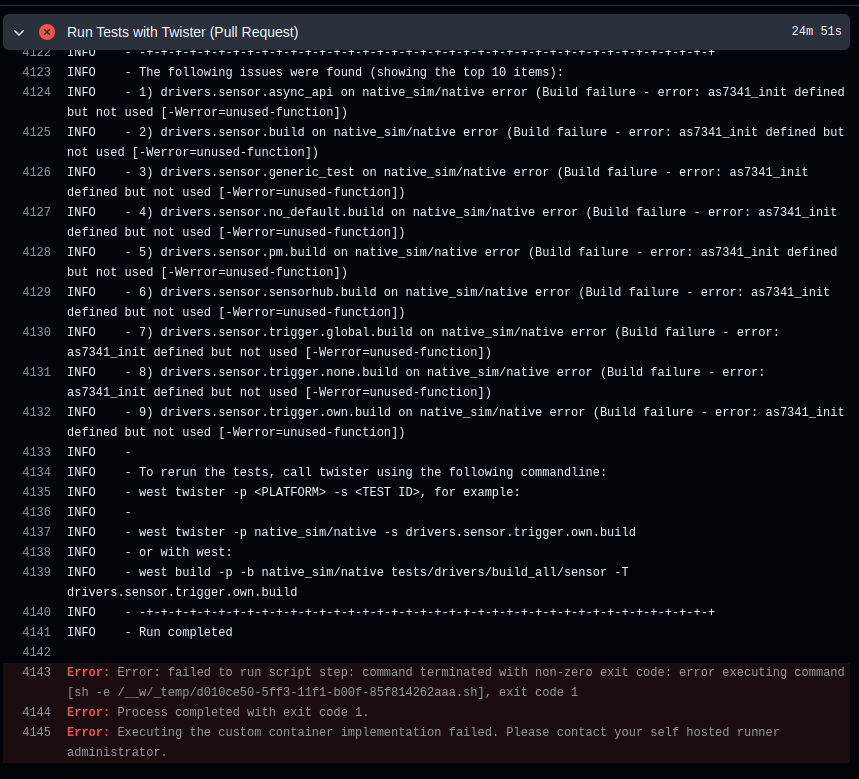

## CI Failure
However, after creating the pull request, CI fails during the Twister build stage.
From the CI log, I see errors similar to:
```text
error: as7341_init defined but not used [-Werror=unused-function]
and multiple failures such as:
```text
drivers.sensor.generic_test
drivers.sensor.no_default
drivers.sensor.pm
drivers.sensor.trigger.own
The failure seems to occur on the **native_sim/native** build configurations.
Screenshot attached below for reference.
## My Questions
1. Why does the driver pass local Twister testing but fail in Zephyr CI?
2. Is `as7341_init()` expected to be conditionally compiled using a DT_INST macro?
3. Could the failure be caused by:
* Missing `DT_INST_FOREACH_STATUS_OKAY()` usage?
* Missing device instantiation macros?
* Missing Kconfig dependencies?
* Driver being compiled even when no AS7341 instance exists in the build?
4. Are there additional sensor-driver tests that must be added beyond a simple ZTest application?
5. Is there any recommended checklist for contributing a new sensor driver to Zephyr/NCS?
