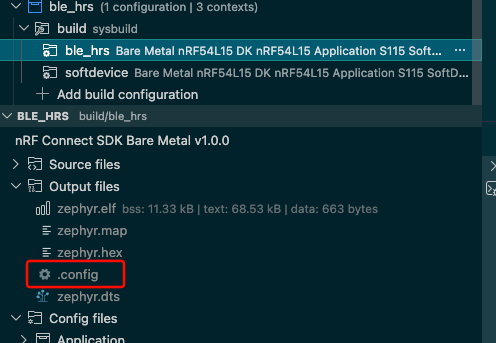

  • Dear Philipp,
    You also have the console which will print the boot banner on startup before the logger is enabled (Note: console is selected by default by the board file). Please try with the following configuration in your project configuration (prj.con):
    CONFIG_LOG=n
    CONFIG_LOG_BACKEND_BM_UARTE=n
    CONFIG_CONSOLE=n
    CONFIG_BM_UARTE_CONSOLE=n
    CONFIG_NCS_BARE_METAL_BOOT_BANNER=n
    You may also look at the .config output to verify what configurations are applied to your build.
    Vidar
