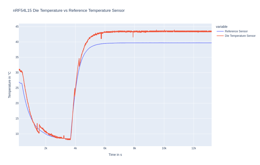

Currently I'm evaluating the nRF54L15 die temperature sensor. I’ve taken a few measurements and noticed something I don’t quite understand yet. Perhaps someone could help me out.
This is the measurement I did:

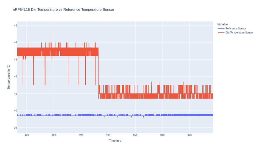

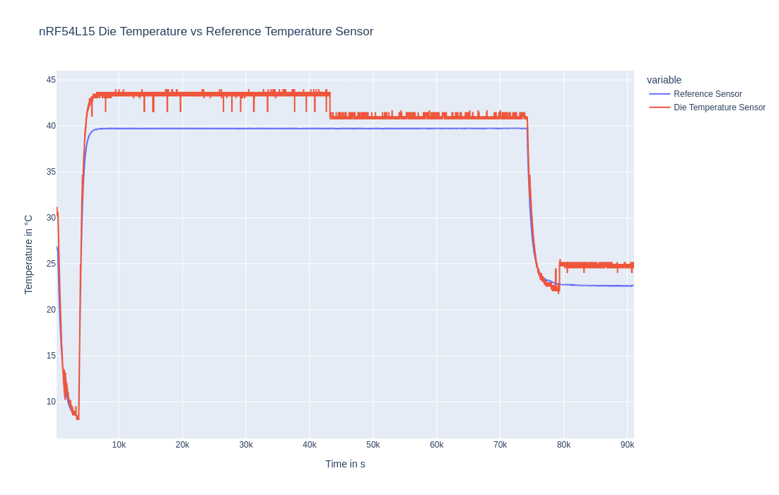

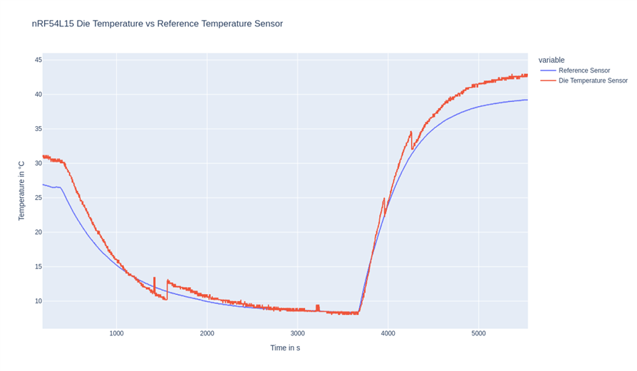

I have noticed some discontinuities in certain places (e.g. at around 25 °C or 35 °C). These seem to occur more or less always in the same spot. However, I have also taken other measurements in which certain discontinuities were not present.
Where do these come from? Is this normal behaviour, or is there something not quite right yet?

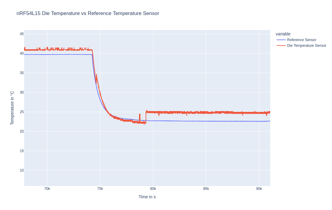

    This offset calibration is our plan. But our biggest problem is at the moment the discontinuities of the sensor signal. It seems that it jumps at certain temperature levels and we don't know why yet.
    Because a static offset correction is useless with these discontinuities.
    Do you know why this happens or do you know a solution for that?
