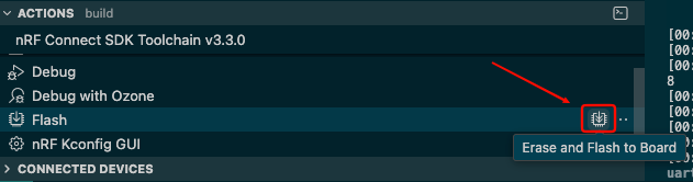

    FPROTECT is limited by the available RRAM protection regions on this chip as mentioned here: https://nrfconnectdocs.nordicsemi.com/ncs/latest/nrf/app_dev/device_guides/nrf54l/dfu_config.html#nvm-protections so to be able to keep FPROTECT enabled in the bootloader, you will need to reduce the size of the bootloader, which you already did through your DT overlay. Given this limitation I agree that it does not make sense to have 64k allocated the bootloader slot by default.
    Regarding the boot issue, perhaps you are missing the provisioning step: https://nrfconnectdocs.nordicsemi.com/ncs/latest/nrf/app_dev/device_guides/nrf54l/dfu_config.html#nvm-protections.
    The public key is automatically provisioned to the KMU if you use the
    west flash --erase
     command. Button to invoke this command from the VS code extension:
    Vidar
