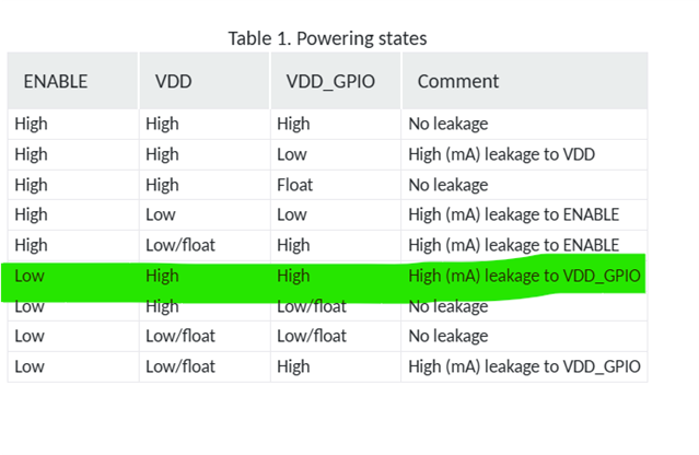

    By checking the powering states table, it is clearly mentioning keeping enable low while VDD and VDD_GIO are high will cause high leakage current. So Based on your limitations, better to not pull down enable pin.
