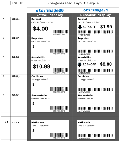

ESL PoC using nRF5340 AP + Nordic nRF52833 tags (Waveshare 2.13” EPD), nRF Connect SDK v2.5.1
I am developing an ESL proof-of-concept based on the Nordic Bluetooth ESL reference architecture and transitioning toward a small-scale PoC production (≈100 tags). I have completed the ESL demo using nRF5340 (AP) and Nordic nRF52833 (ESL tags) with Waveshare 2.13” EPD.
I require technical assistance in the following implementation and HW design:
  1. Do you provide a reference schematic / hardware design package for nRF52833-based ESL tag PCB design, including RF antenna layout/matching guidance, coin-cell power design considerations, and recommended SWD/production test interface design?
  2. About bulk price update, I have tested a demo bulk price update using a Vendor Specific OpCode (0x2F) on the AP and distributed to tags via PAwR. Tags correctly receive and process the update but do not send any response, the log shows: <wrn> bt_hci_core: opcode 0x2083 status 0x46. I have shared the tag log with you for further analysis and assistance.
  3. Is it feasible to directly transfer layout images from a PC to ESL tags using mcumgr, or is OTS the only recommended method for provisioning layout images to the TAGS?

    2. Based on the fix you have provided, I will analyze the code again but Could you advise on the best way to implement bulk price updates? Assume the AP has to send price updates to 100 tags.
      For testing, the 0x2F command that I tested contains only 4 bytes unencrypted payload size per tag which follows the examples in esl_dummy_cmd.c as shown below:
      case 0x14: /*type 0X14 Tag 0~10 Display img 2*/
      case 0x15: /*Vendor-specific command VS_DFU_REQ = 0x1F*/
    3. I'd be glad to hear your team's suggestions on this as well.
    1. Also check with the display manufacturer.
    2. Assuming you have sent prices already to all tags (each tag received multiple images), and you want to tell to all tags "switch to image number 2" at the same time--> then if you have 100 tags, one approach could be to put all 100 tags into the same group and send a broadcast message. Though this is probably less scalable in the future, or you can put one tag per group, and then you need to send specific commands to all groups, it depends on the latency requirements, and the scalability.
    One important thing to keep in mind: if you send a broadcast message (you use 0xFF) in the payload of the ESL message, all tags in the group will receive the message and will process it, but they will not send a response. This is by standard: you have up to 256 tags in a group, and there are not enough response slots to allow all tags to send response immediately after the command.
    3. I checked. Not out out of the box no, why would you want this? Over USB or BLE? You would need to modify they code.
    Kenneth
  • Hi Kenneth,
    1. Yes, I have reached out to the display manufacturer, Waveshare. I hope to hear from them soon.
    2. Noted.
    3. This is important in the design because each tag displays unique static content (product title, description and barcode). We therefore use a Python script on a PC to pre-generate all display images. For example, 1,000 tags require 1,000 unique images since each tag’s content differs (see snapshot below). This implementation will allow the tags to focus on only price & discount updates by writing them on the display image. USB is preferred to enable use of the mcumgr tool after flashing firmware to the tags, but we are open to your recommendation between USB and BLE.
