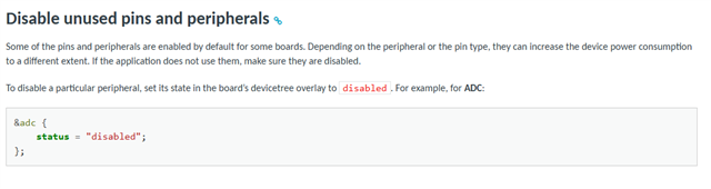

  • Hi
    1. A GPIO that is not mentioned in the .dts or overlay files of your project will be left floating, which means it will not necessarily be in a low power state and can indeed leak.
    2. Please check out this part of the documentation on how to verify idle current and how to disable unused pins/peripherals: https://nrfconnectdocs.nordicsemi.com/ncs/3.1.0/nrf/test_and_optimize/optimizing/power_general.html#verify-idle-current-due-to-other-peripherals
    In general, in the Zephyr RTOS when no threads are called by the main thread, the RTOS will make sure the device/application goes into the lowest possible power mode.

  • Questions:
    1. This in not clear for me:
    I have created own board for my design that includes  <nordic/nrf54l10_partition.dtsi>.
    Should I use  "status = "disabled" for all peripherial that are available in nrf54L10I, but I dont use them?
    Or maybe only some unused perihperials  should by manually disabled ?
