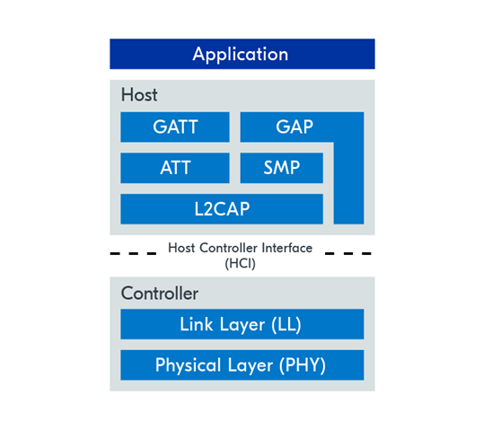

  • Hi Klaus,
    As I mentioned all BLE packet when in connection are ACKed at the link layer. Link layer is very low in the BLE stack right above the PHY layer:
    A new LL packet only sent if the previous is ACKed.
    But on the ATT layer there is no acknowledgment for notification, this mean the sender has no way to know if the receive has received the notification packet at the ATT layer on the destination (the link layer can ack but the ATT may not receive/process the packet for some reason). The sender may send next notification even though the first notification has not been processed. This is different from indication that the new indication can only be sent if the pervious indication has been ACKed on the ATT layer at the peer device.
