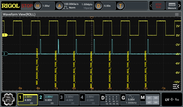

The layout of my timeslots is as follows (the scope traces show a 1s reference clock, and a GPIO which is just being used as a timing flag for observation):
All timeslots requested are 40ms long, and as you can see, the cadence is as follows:
SLOT 1: (Type NRF_RADIO_REQ_TYPE_EARLIEST)
This is scheduled close to the falling edge of a 1.0 second clock. I have no expectation of the accuracy of the arrival time of this slot.
SLOT 2: (Type NRF_RADIO_REQ_TYPE_NORMAL)
The distance of this slot from the previous (EARLIEST) slot will be close to 1.0s, but is calculated and scheduled appropriately to arrive right on the next falling edge of the 1.0s reference clock. This is the first slot whose arrival time I care about.
SLOTS 3 and Subsequent: (Type NRF_RADIO_REQ_TYPE_NORMAL)
These are all scheduled to be exactly 1.0s after the previous timeslot.

    The time available for timeslots depends on how much radio time the SoftDevice consumes, which depends on the number of connections, connection interval, and connection event length. See timeslot Performance considerations). I believe the most important you can do is to reduce event length and/or increase the interval, to make more room. You should probably also incrase all timeslot priorities to NRF_RADIO_PRIORITY_HIGH (unless you want to prioritize all BLE traffic), as all any BLE activity will block normal priority timeslots (see SoftDevice timing-activities and priorities).

    Following the AI advice, I have increased the minimum connection interval to 200ms with a longer maximum, and the system is working fine. I also seem to have to reduce slave latency close to zero (I'm using zero) or I get multiple failures. I'll investigate that further when I get the time.
