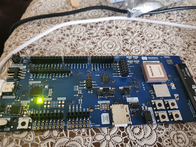

Both Conexa and Onomondo SIM card don't work in NRF9151
I am doing Dev Academy course for the Cellular IoT using the NRF9151-DK. I was able to follow the tutorial to the point where I was able to claim the device using a token I received using the attestation command.
However that is far as I have been able to get. I tried performing the provisioning step by holding down button 1 for 3 seconds or even longer with the hope of the provision process starting but nothing happened.
This led me to start looking at the logs that was printed from the serial port which indicated that there was no SIM card detected. I tried putting in the each of the two SIM that came in the box but the log still continued showing that the SIM can not be detected.
I believe that I am running the following firmware version according to AT command
uart:~$ > at AT+CGMR
at AT+CGMR
mfw_nrf91x1_2.0.4
OK
Below is the log from the board

[00:00:00.971,252] <err> network: No SIM card detected!

So is this a SIM or NRF9151-DK or firmware problem?
