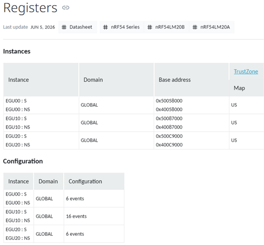

nRF54LM20 EGU00 Peripheral not present in Zephyr
Board: nRF54LM20A DK
NCS: v3.3.1
I was trying to work with the EGU00 peripheral on the nRF54LM20A, and I realized that it is not present in the device tree definition files from the nRF54LM20_A_B.
Does the EGU00 peripheral actually exist?  It is present in the micro's datasheet and documentation:
https://docs.nordicsemi.com/r/bundle/ps_nrf54lm20a/page/egu.html-topic
  • It is possible to use the EGU directly through nrfx.

    Something like this should work. Set CONFIG_NRFX_EGU10=y in your prj.conf. While this seems to select EGU10, it will still permit you to use EGU00.
