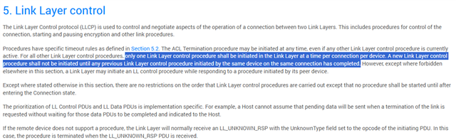

    It's not possible for the application to override this, the problem in this case is that Rohde & Schwarz are violation of BT core spec, from volume 6, Part B, chapter 5 it says:
    "only one Link Layer control procedure shall be initiated in the Link Layer at a time per connection per device. A new Link Layer control procedure shall not be initiated until any previous Link Layer control procedure initiated by the same device on the same connection has completed."
    You should reach out to Rohde & Schwarz and ask them to change their test, it is possible to do this other ways than violation of spec, but it must be implemented by Rohde & Schwarz.
    Kenneth

    ==> Comments from R&S for your reference,
    The 'Connection mode' measurement on the CMW platform uses the LL_Feature_Req/Rsp as the mechanism to perform receiver (PER) measurements.
    So, we are using this measurement mode as a way of allowing customers to test RF performance OTA.
    However, in order to allow this mode of operation to work means ‘bending the rules’ of the Core Specification – I.e. it has been done by design and not by accident.
    If we didn't do this then the measurement would not be possible.
    Other devices don't have a issue with this approach.
    We have already discussed it with the Nordic engineering team
    The input have been forwarded, if I hear anything back I will let you know.
